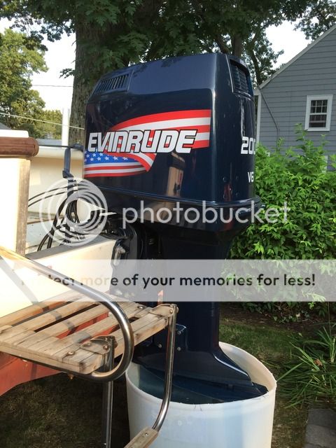

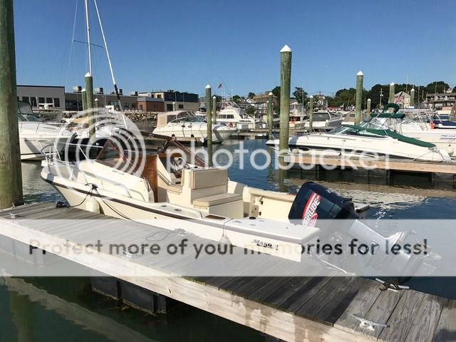

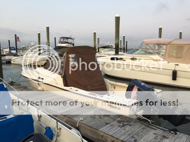

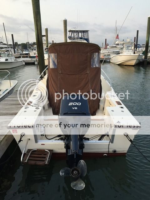

    Heading into the third season with this one. My first Mako but not the first boat. It's powered by the original 1990 evinrude 200 which runs great and got a total cosmetic restoration last spring on top of all new engine electronics (regulator-rectifier, power pack, timer base and plug wires). I do a lot of striper fishing in the Boston harbor area and occasionally take the family for a harbor cruise.
    Contemplating a bracket and repower along with some light cosmetic and mechanical system upgrades but having a hard time finding someone with those capabilities in the Boston area.
