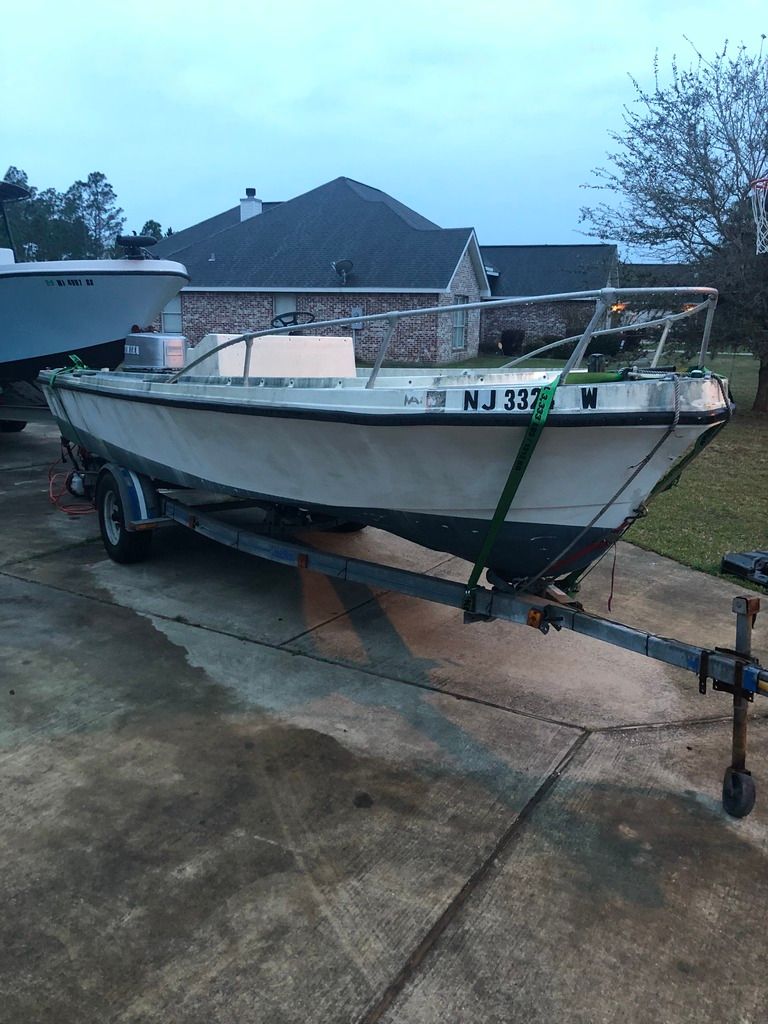

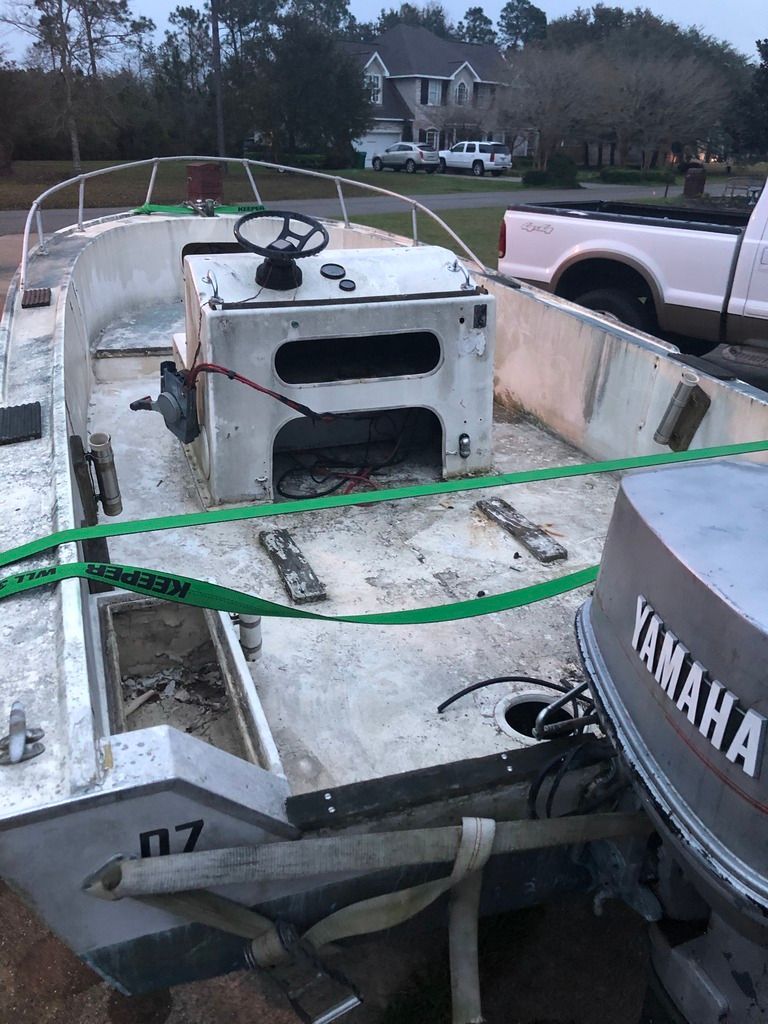

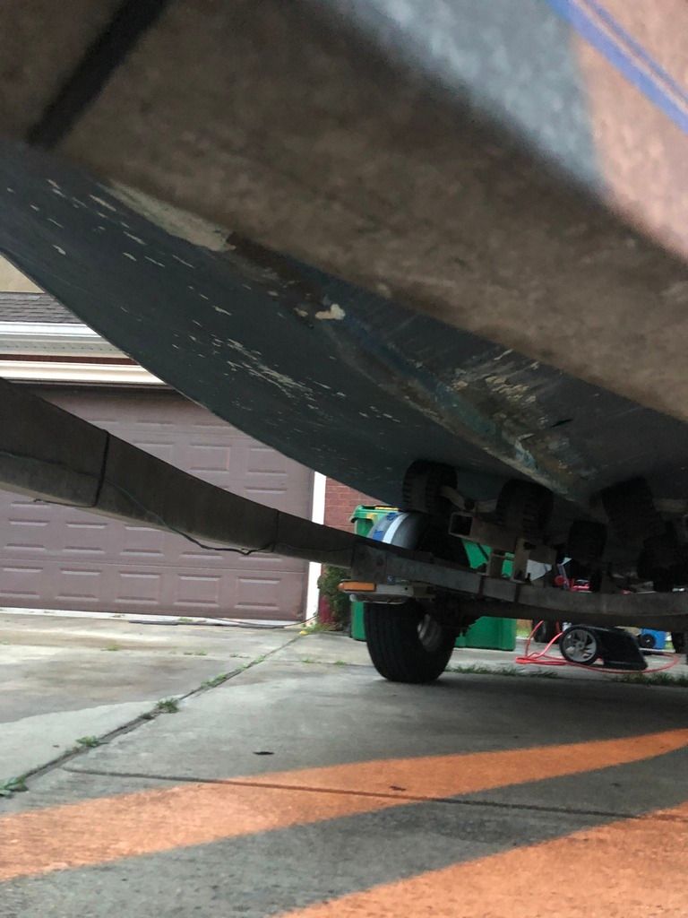

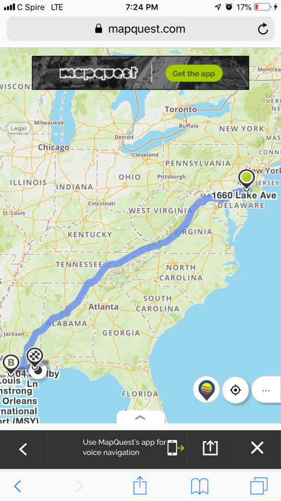

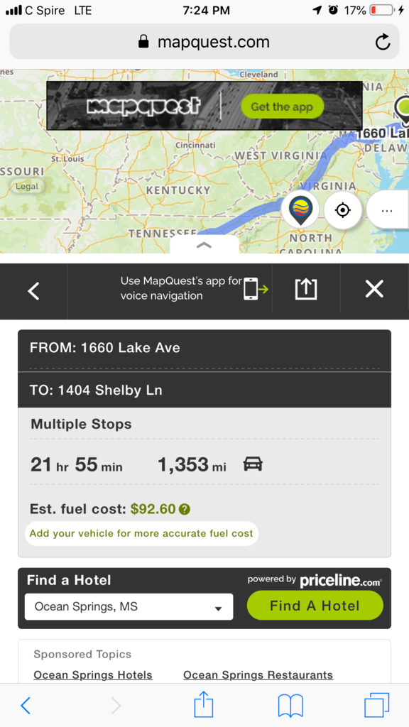

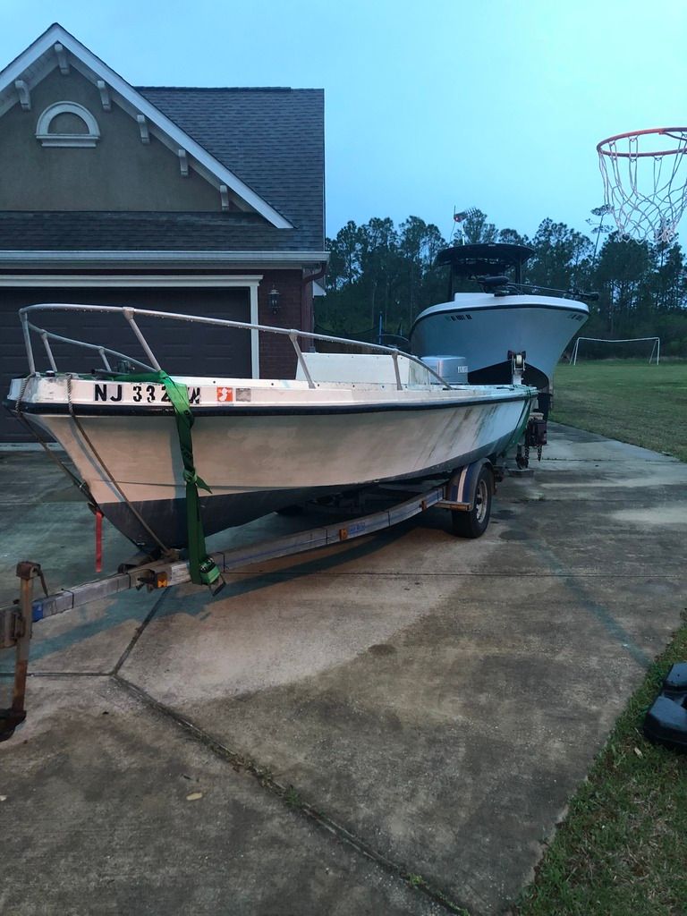

    So after a one way flight from Nawlins to Philly, a rental truck, 1350+ miles, and some 22 hours of drive time over 3 days.... I bought a first 40. I guess Im no stranger to road trips to get boats because Ive drove to Texas twice. Once for a 21 that I never finished and ended up selling and also once for my 261 that I still have. This boat popped up on the forum back in 2012 - 2013 when a member spotted it in a boat yard and then after no one on here pursued it, it went in ghost mode until I saw it pop up again in the classified section early this year. I was ready for a new project and luckily had 5 days off from work to go pick it up so I felt like it was calling me! The floor is shot as I can almost put my foot through the front deck. So along with that shell be getting a new Seacast transom and stringers. Ill try to keep it as close to original as possible within reason
    I was extremely pleased with the condition of the hull other than the deck. I plan on doing all the demo and as much of the seacast work that I can with the help of my dad when time permits. What I cant do, I have a fiberglass guy who I know can handle it... just trying to save some money and scratch my restoration itch at the same time. Any and all input from everyone who has tackled a pourable transom or stringer job is welcomed and encouraged. Cant wait to get started ! Stay tuned!

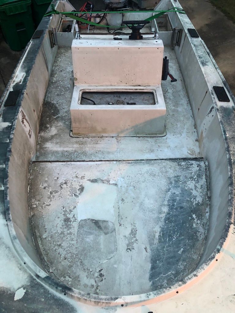

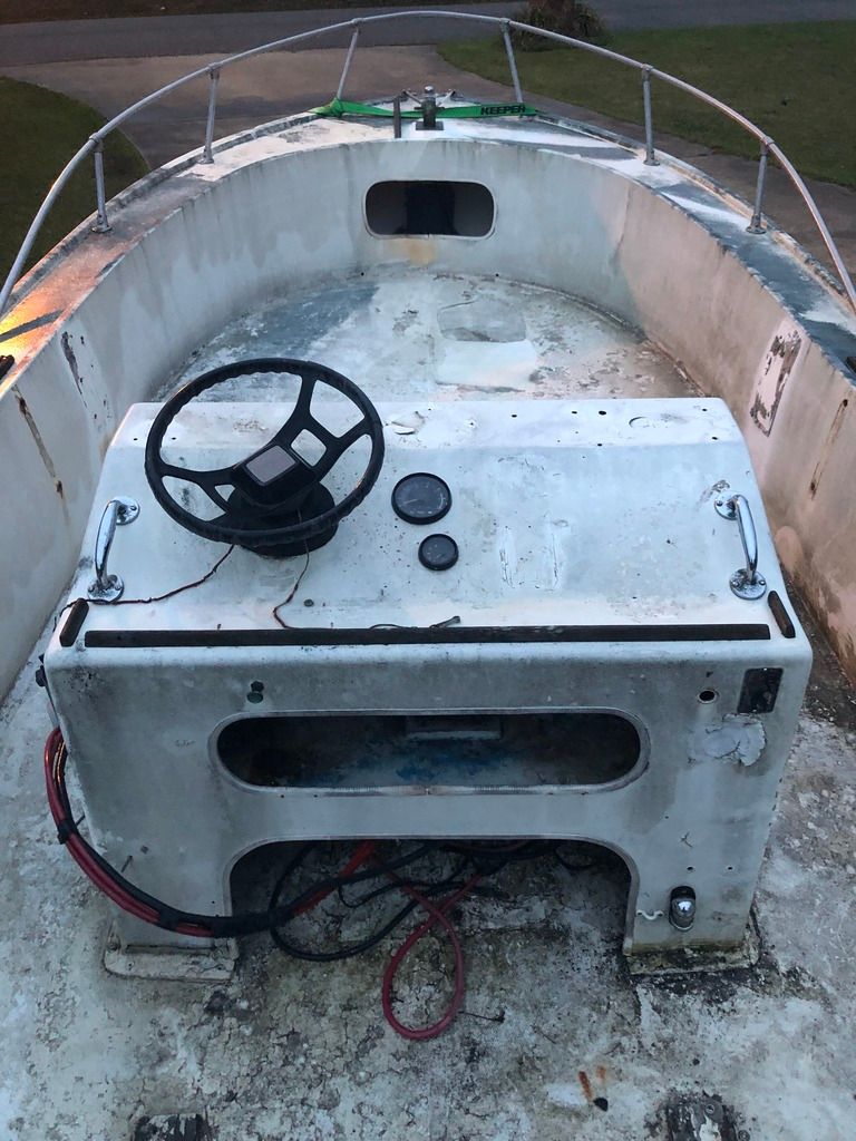

        Pressure washed the boat for about 2 hours today to get rid of all the neglect from years passed. Unfortunately the deck is so bad and the drainage design on these things are so bad that Im having to stand in dirty water when doing it. Really thinking of leaving the floor for now to help hold shape, pulling the entire cap, flipping it over and coring all of the gunneling. Then cut the floor out before reinstalling the cap. Once cap is on, install a new floor. .... after transom and stringers of course [B)]

              So how much should I leave myself when cutting this floor out ? My skill saw is about 1 3/4 from blade to end of the fence. Should I scribe a line and give myself a little more for tabbing back in ?

                  Cut all the way around and left myself 3 to be safe. Then used a hole saw to cut a hole right in front of the bilge access. Looped a dock line through it and hooked it to the truck and snatched the floor right up. Cant believe it worked that easy []
                  I did however forget to remove my drill from the boat when I yanked the floor loose. Drill went flying about 20 ft. Now clutch doesnt work. Oh well Ill trade that $100 drill any day over manually ripping up that floor.
