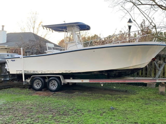

    After almost 14 years the 224 has found a new owner [:0][]. The best way to get over a beloved usable project is to dive into a new usable project.
    When brought home...
    After yesterdays wetsanding fun...
    The blue boot-stripe came off easy, and this bottom paint is easier than the 224. I will do what I can easily access, but have no desire/intention to block and lie underneath this beast. Yesterday was done by hand (I hurt), but I will be getting disks and new air DA; the old one got tossed after 224. I was able to smooth out where name was, and will finish out sides following Dodge's steps; 3M Marine Compound and Finishing Material, 3M Finesse It, & Colinte Marine Wax.

          I do not suspect anything major in immediate future. I will absolutely be removing the bow rail, and will find someone to repair those holes long with a few others (oil tank fills, placard rivets, etc...). The boat really seems to be very solid and I know the 26 year old tank will be an issue, but I would like to get rigged, used, and deck bloodied before anything major.

                            Justin - I did bust out the Easy-Off. I hit starboard side with a can, let sit while I cut grass, and then hit with powerwasher. It really broke up the blue boot stripe and it came right off. The bottom apparently has layers and I could see paint coming off, so I'll likely hit 1 more time before I sand bow area.
                            Immediate project is figure out how to replace this cross member with boat on trailer...
                            I replace front L beam to install keel bunks, but bunk brackets do not fit the I beam. I have all the parts, just have to figure out how with boat on trailer.
                            I need to be able to splash to sell running motors. I know if I want to sell these older motors I need to have on boat and let potential buyer run.
