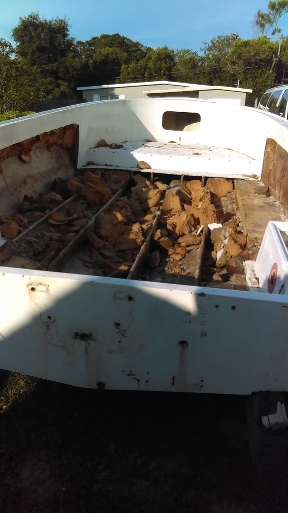

    Finally found time to start the rebuild process of my 19" 6. Me and a buddy of mine cut out most the deck and started removing the old water logged foam. Next, I plan to cut out the stringers and glass the bottom. My questions for you guys out there are. I know your not supposed to cut all of the stringers out in order for the hull to maintain its shape, but which stringers should I cut out and which ones should I not cut out. Also, which type of glass should I use to refiberglass the hull.I'm thinking about using prisma preformed stringers and having a below deck fuel tank and a coosa board deck

    you can cut out all of the stringers but YOU HAVE TO BUILD A PROPER SUPPORT FOR THE BOAT TO HOLD THE SHAPE!!!!!!!!!!!!

        Take the boat off the trailer and set directly on the floor like on a concrete slab. Let the belly rest and block up the sides and level the boat. Once the boat is secure like that then you can cut out all the stringers. Just not a good idea to do on the trailer. Way I've done it for years and never went wrong. Good luck

            Are the stringers rotten? Taking the stringers out adds a lot of work and may not be needed. Some people still do it, but make sure you want to. I did not, but I did a lot of things a little differently on my 19.
              Yes, the stringers are rotten. Pretty much all the wood is water logged, and all the fiberglass matting is exposed. I'm going to cut the middle stringer out first and sand it down and reglass hull and add new stringers. The transom seems solid but I don't no if the wood is good. I might have to replace it as well, I would really like a full transom with porta bracket

                  Do you guys know what type of fiberglass mat I should use to laminate hull and how many layers?

                    I used 1808. Sometimes 1.5oz mat in between.

                        Did a little more demolition work this past Sunday. I tore out more of the deck and more of the foam.all that is left is a little up from near the forward deck hatch and under both gunnels. I think my first step will be to replace the transom then stringers. Any suggestions?

                            Do your trailer bunks run the length of the boat? Before you do anything with the stringers its gotta be supported properly...any distortion will be made permanent when you replace the stringers. When we did mine we determined that the 4" x 6" cypress bunks on my trailer were OK for support and everything was nice and straight and the hull was not racked.
                              Grinded the transom skin clean
