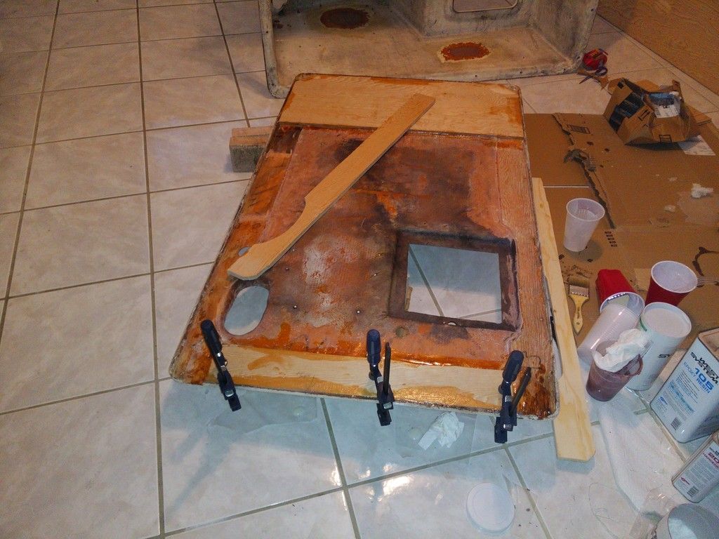

    This worked very well by the way
    This is the stringer section I'm talking about

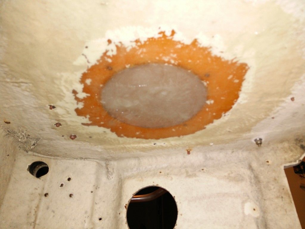

    Did you apply the tape over the holes in the coffin? Or has someone else already pulled the tank? Or is the tape a factory detail?

      I put the tape over it temporarily as it was about to rain. I'll glass over the holes when I put everything back together.

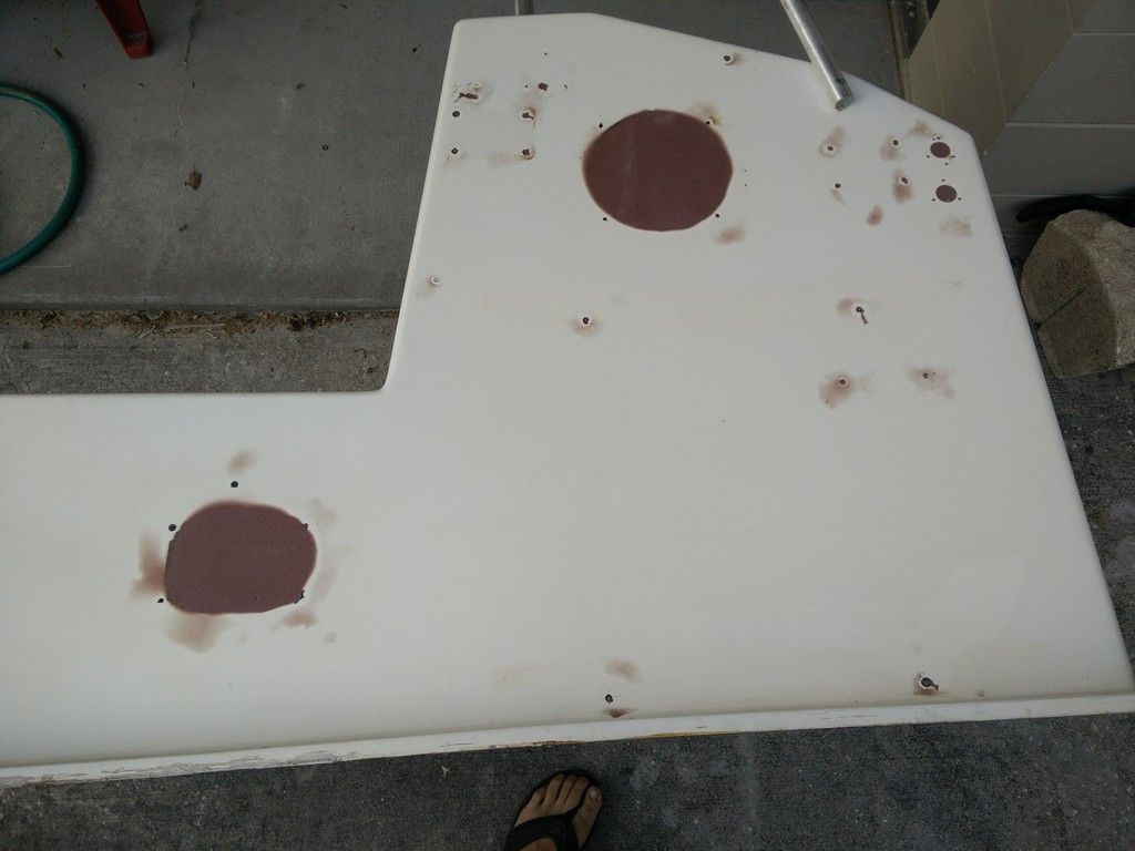

        Holes are being patched on console.

          just curious, how are you glassing in the holes in the center console?
          [br]1985 17\' Angler 130 Yamaha[br]Miami, FL
            I used West epoxy to lay up a couple layers of glass on the inside, let it cure, built up the void with a couple layers from the outside. Then mixed epoxy with the 407 fairing compound, apply, let cure, sand till smooth and level.

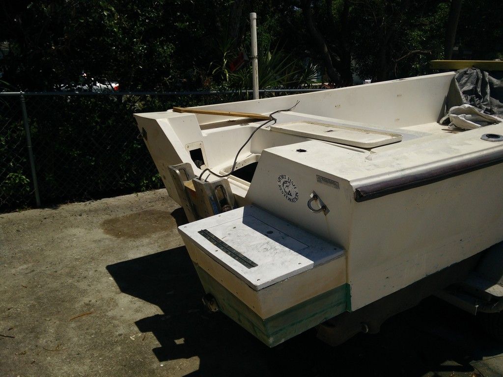

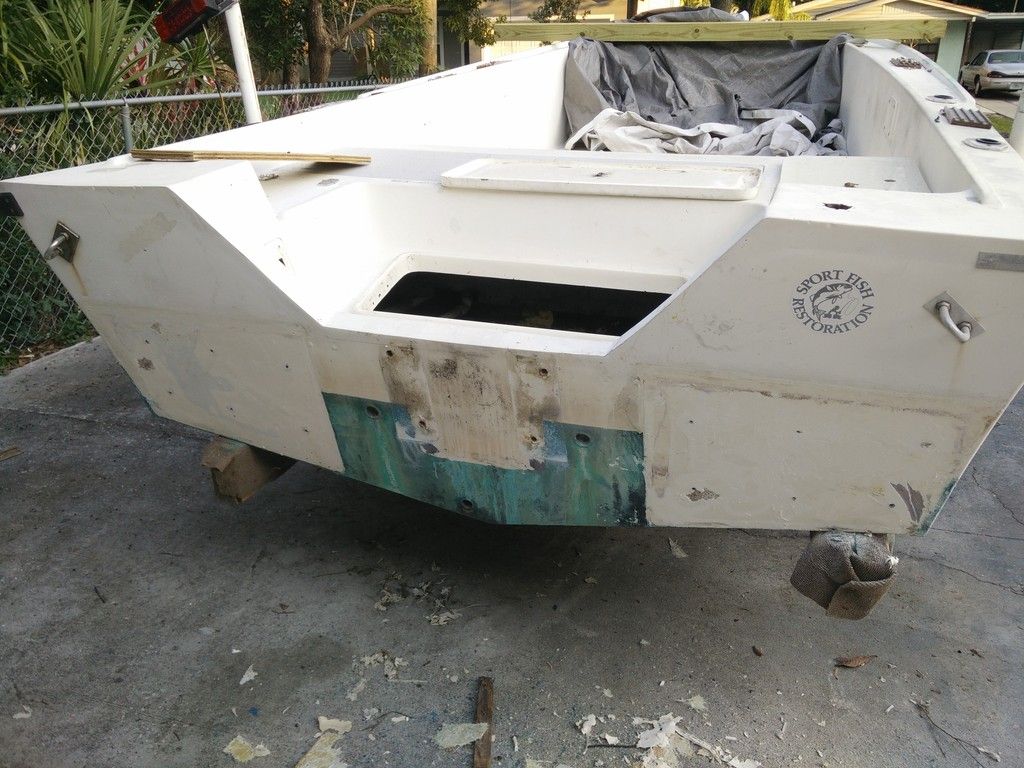

              Motor is gone
              Getting that baitwell off was a real pain, ended up taking about half the day. Never have I seen so much 5200.
              Best news is that the transom is soild as a rock. motor mount holes look great.
              I've got alot of fairing and sanding to do on the transom.

                            Looks good so far! Glad the transom is solid, one less project.
                            Are you planning on putting those transom bait wells back on? If not, I have been looking for some for my 17 project and would be happy to discuss terms to take them off of your hands []
                            Keep up the good work!
                            -Jay
                              -Jay
                              I won't be reusing the Wells but the boat only came with one side and it was destroyed in the removal process. I do have both lids still.
