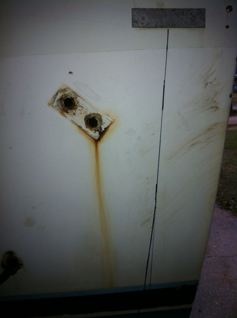

    Marked my cuts four inches inside. Looks like it's pretty far in, but pictures look different. Thoughts? I think this is what Mackey, Chuck and Delgado measured.
    This is the biggest project I've ever done so any opinions, comments, etc are welcome!
    • #32
      I think 4 inches in may be little much I was thinking 2 inches but as wet as your core is it may be no big deal.As long as you can get core out from behind the lip then it is okay.Remember always better to cut like you did then cut too much off.As long as you got something to tab to is all its for
      • #33
        Removing the outer skin is what I did on the 224, when replacing the core with Coosa. I left ~3", and found than an electric chainsaw was the cat's meow for removing the coring from the gap.[]
        IMHO, you don't want any less than 2", as you'll want to feather the joint to get a solid joint for the outer skin re-install.
        When you indicated you were going to add splashguards. I assume this is going to be part of the pour like Chuck did?

                I plan on using the electric chainsaw until it's clean or the saw breaks! Going back and looking at other projects, three inches seems to be a good amount to leave for the lip around the cut out.
                I will be adding splashguards very similar to what Chuck and MrDelgado did on their rebuilds. I'd love to go full transom, but it's not in the cards yet.

                        So you're going to tackle the transom!?! Hopefully that core has a lot of rot and the outer skin just peels off like mine did.
                        I like the 4" cut line. I used a chainsaw to get in that 4"gap, scored the core in the middle and then chisseled the rest out. This way it saves your chain.
                        This sure would be a good time to raise the transom 6" and add splash guards. Go up 6 and you won't even need a full transom. Not a drop of water comes over mine...

                              Nice to see this project start and I've been waiting for it. Lots of possibilities on the many directions this could go and I like the Nidacore decision. If you are set on keeping the 25" motor at least go with a notch transom. I raised mine to 30"and then cut down to 25" when I found a e-Tec deal that could not be refused. Sometimes you decide on the fly and the end game changes, but I'm happy so far.
                              If you need any help on walking through the process or just want to talk to keep your sanity before making the most difficult cut - also known as the first cut, I'd be happy to share what I know from my project and would be happy to discuss. Just let me know.

                                Thanks Dave - I appreciate the help and will be taking you up on the offer. I definitely plan on a notched transom and wish I had a 30" motor right now so I the entire motor would be out of the water when it's in the slip. Right now, I can raise the motor all the way up and the lower will stay out of the water as well as the top of the trim rams, but I sure would like the rest of it out as well.
                                I'm planning on cutting it open this weekend and removing the core. I pulled the drain plug out last night and even though it had a split in the tube, the wood surrounding it was surprisingly solid. All left to do before cutting is to remove the three thru hull fittings and the cutting will begin!
