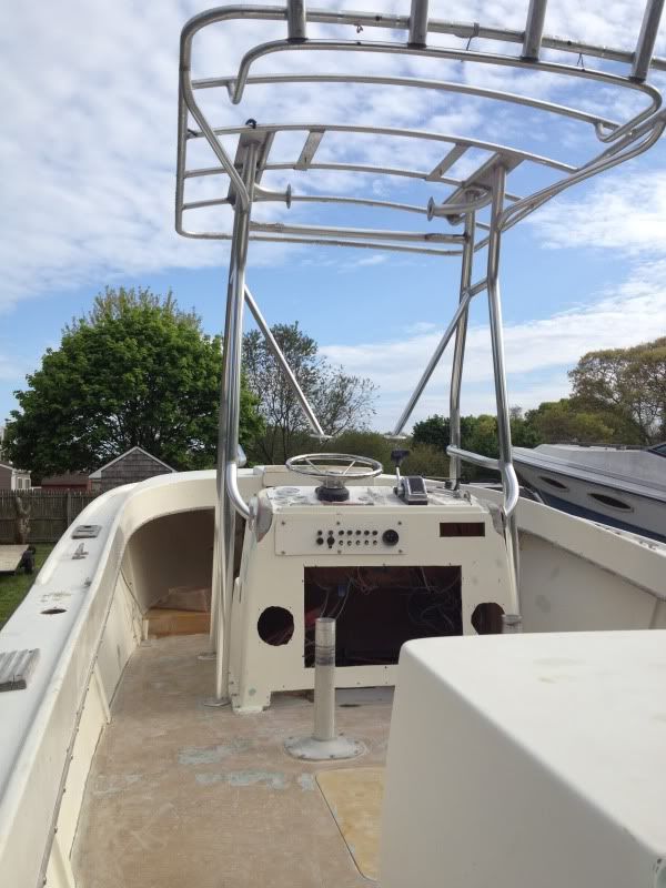

      HERE SHE IS. A LITTLE ROUGH ON THE OUTSIDE BUT WILL GET TO THAT NEXT SPRING. INTERIOR WILL BE DONE SOON.

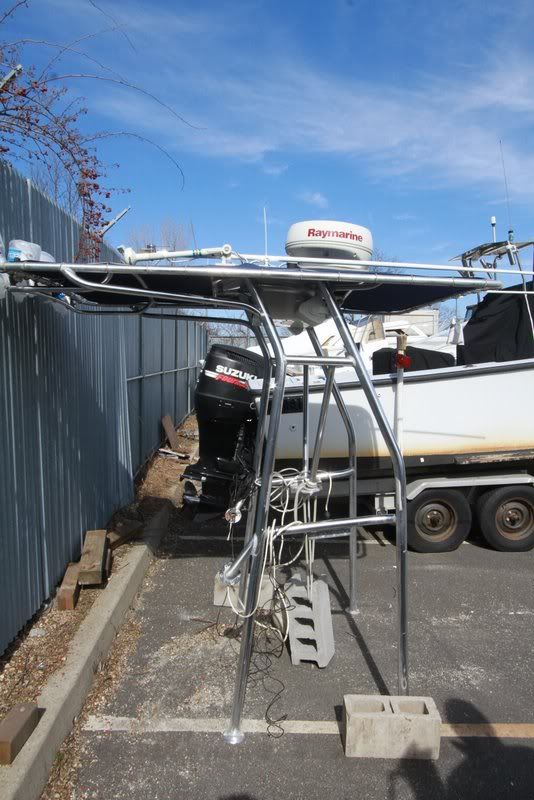

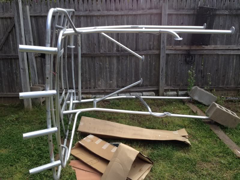

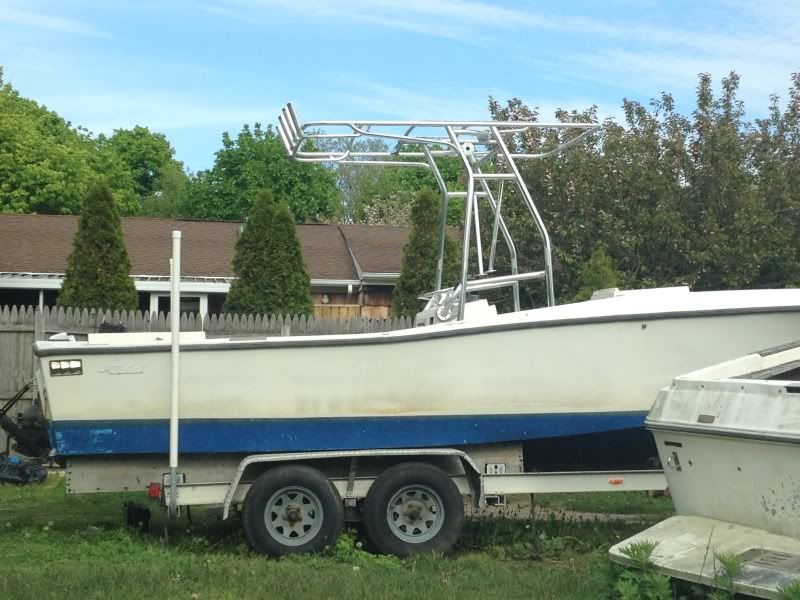

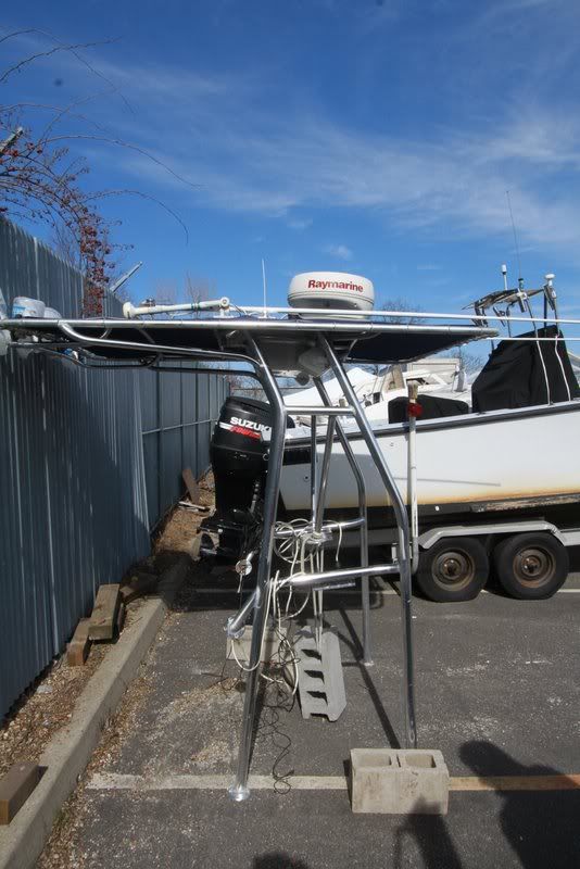

      THE TTOP THAT STARTED THIS PROJECT. FOUND IT ON THIS CM SITE FROM A BOAT THAT BABYLON BOAT WORKS IS WORKING ON. GOT A NICE PRICE FOR THE SETUP

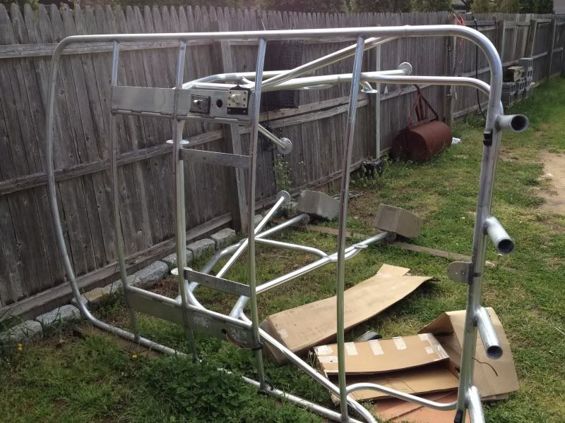

      TTOP STRIPPED DOWN. GOING TO POWDERCOAT WHITE. WHITE STAMOID TOP WITH BLACK STICHING AND BLACK WRAP WILL BE IN THE NEAR FUTURE.

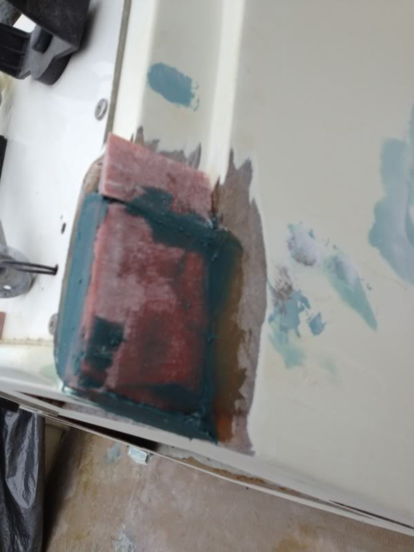

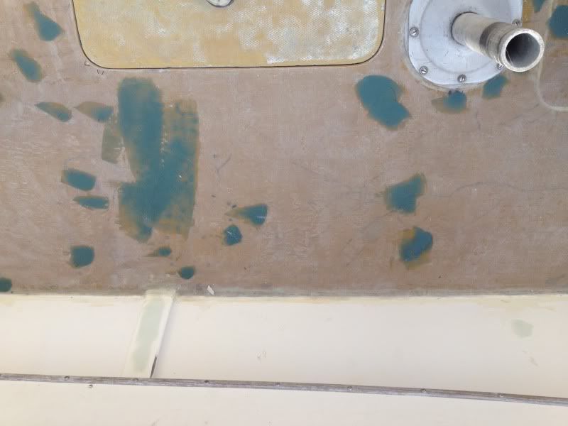

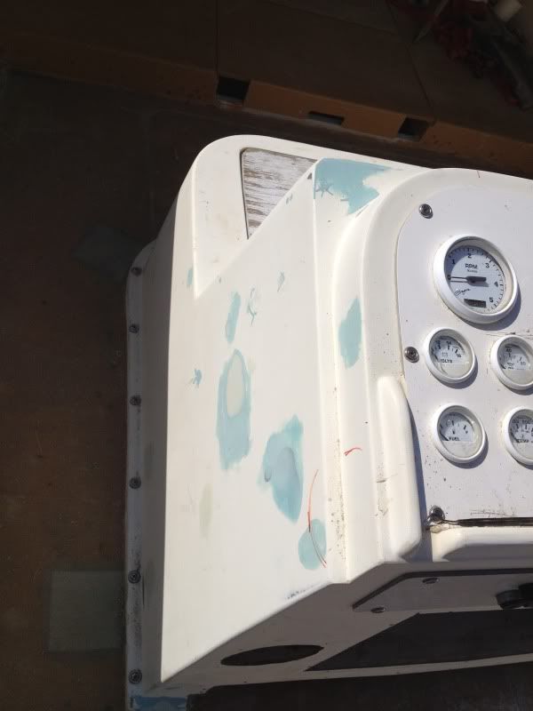

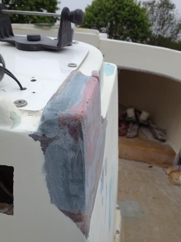

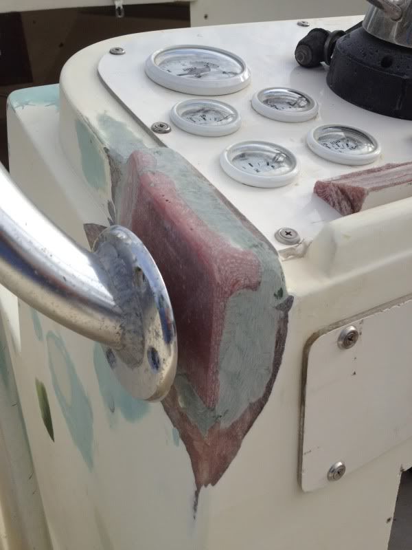

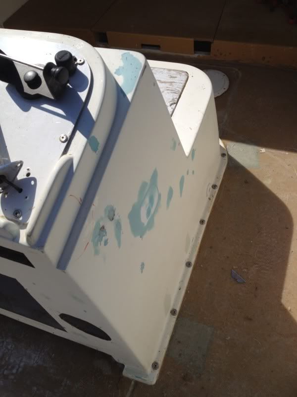

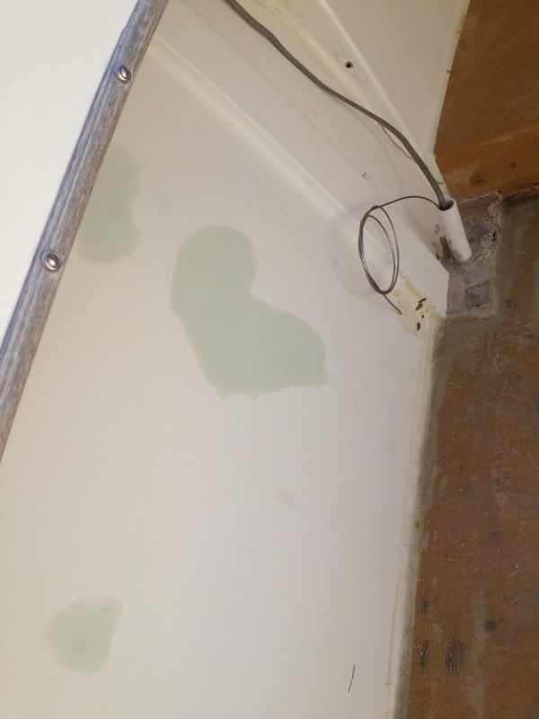

        FILLED ALL THE HOLES IN THE CONSOLE, GUNWALES AND THE MOTOR BOX

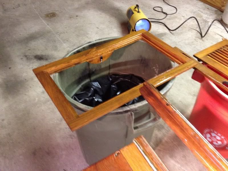

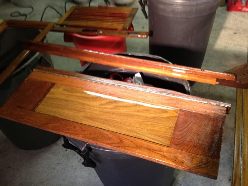

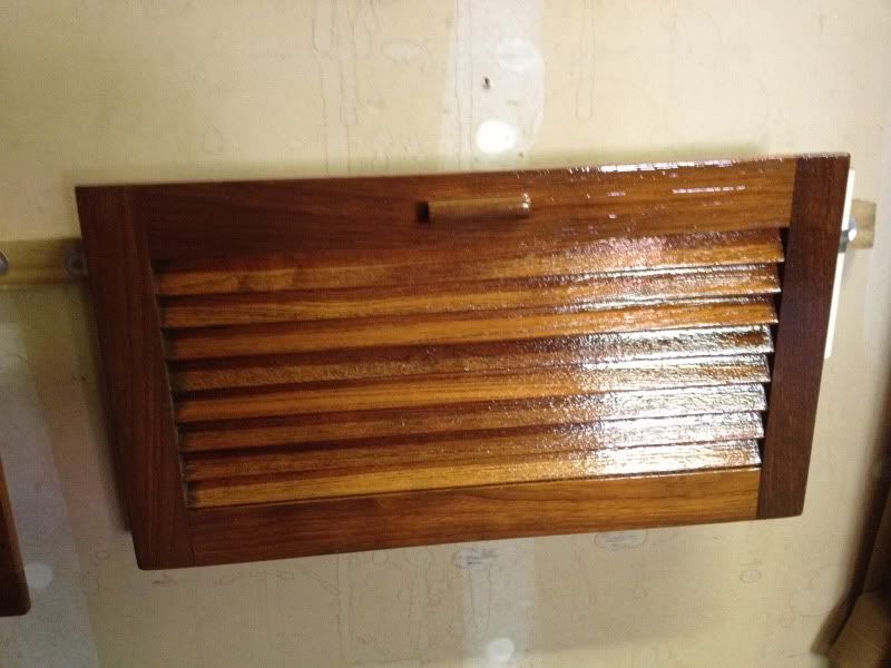

        WAS GOING REPLACE ALL THE TEAK WITH STARBOARD BUT WOULD HAVE COST WAY TO MUCH. THESE CLASSIC BOATS SHOULD HAVE SOME TEAK IN THEM. AFTER SANDING MY DAD SPENT QUITE SOME TIME SANDING THE ORIGINAL AND COATED WITH 3 COATS SIKKENS NATUARL TEAK AND 2 COATS GLOSS IT LOOKS BEAUTIFUL.

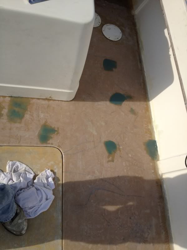

          2 YEARS AGO WE COATED THE DECK AND TO OF THE CUDDY WITH DURABAK. WHAT A MISTAKE IT WAS DIRTY WITHIN A WEEK AND COULD NEVER GETIT BACK. IT ALSO GOT SUPER STICKY DURING THE SUMMER MONTHS. WHEN WE CALLED THE COMPANY TO COMPLAIN THEY OFFERED 10% OFF THE NEXT PURCHASE TO RECOAT. SO THE PAINT STRIPPING SCRAPING AND GRINDING BEGAN.
          NOT THAT MANY PICS OF THIS BECAUSE I WAS COVERED IN RUBBER FOR 3 DAYS

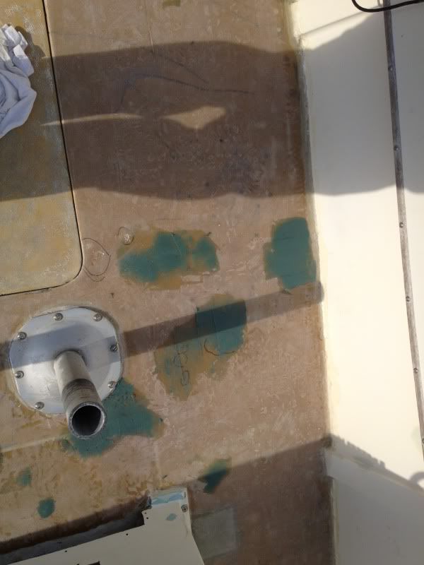

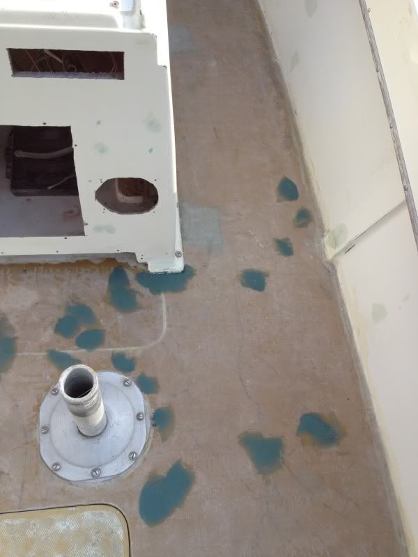

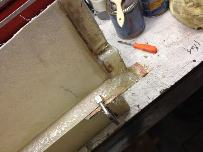

            THIS PAST SATURDAY WE HAD ALUMINUM PLATES PUT IN THE DECK WHERE THE TOP LEGS WILL MOUNT AND AFTER I GOT ALL THE RUBBER STUFF OFF THE DECK AND GROUND OUT ALL THE STRESS CRACKS WITH A DREMMEL. A LAYER OF 1808 AND ANOTHER 3/4OZ MAT FOR THE SURFACE WAS LAYED. THE DECK IS EXTREMELY SOLID NOW AND NO WORRYS OF THE TOP RIPPING OUT OF THE DECK.
            GOUND THE HIGH SPOTS AND FILLED THE LOW SPOTS WITH DURAGLASS. THAT STUFF IS STRONG AND VERY DIFFICULT TO SAND ONCE HARD.
            THE TOP CAME OFF A 1979 231 WITH THE TALLER CONSOLE AND WE DIDNT WANT TO CUT AND CHOP THE TOP SO WE HAD OUR FIBERGLASS GUY BUILD A BOX TO MOUNT TO THE CONSOLE TO CONNECT THE V SUPPORTS AND SINCE THE CONSOLE IS VERY SMALL IT WILL GIVE US A SPOT TO MOUNT THE RADAR SCREEN. WE ALSO REMOVED THE WINDSHEILD AND WILL HAVE A CUSTOM REMOVEABLE ENCLOSURE BUILT IN THE FUTURE.

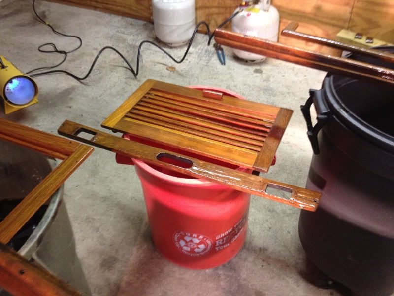

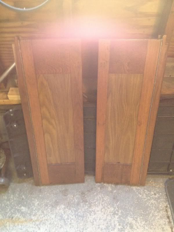

                some other teak pics

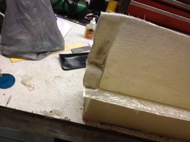

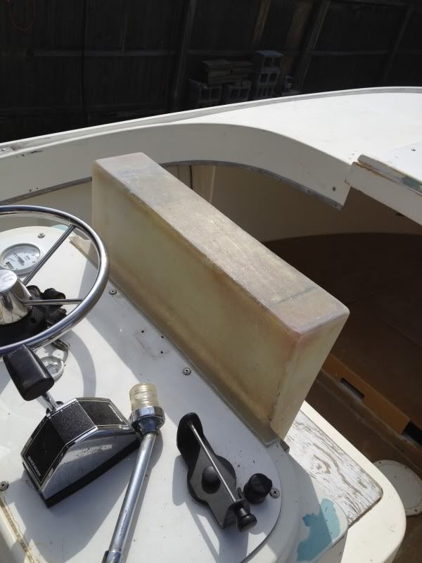

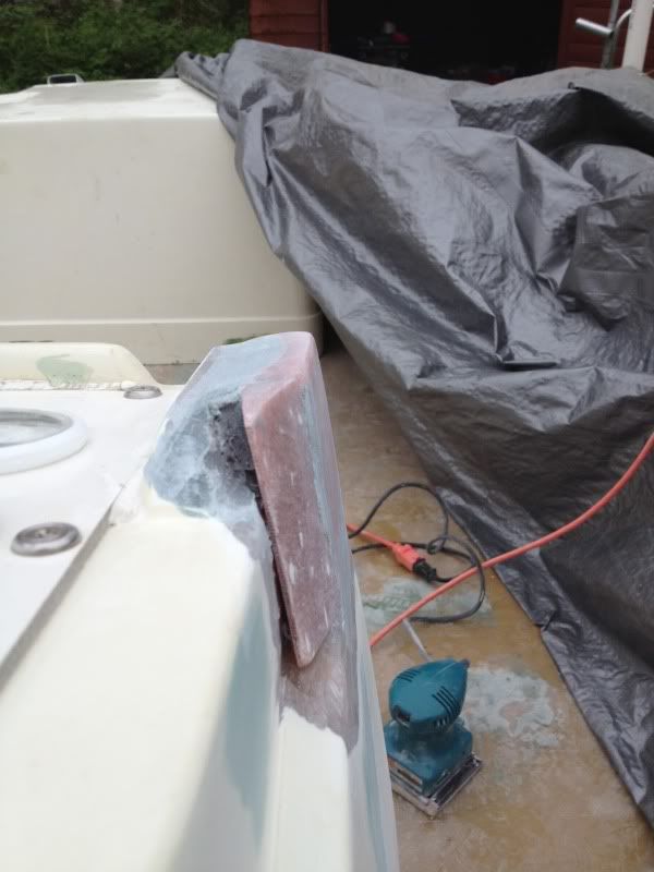

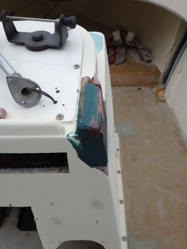

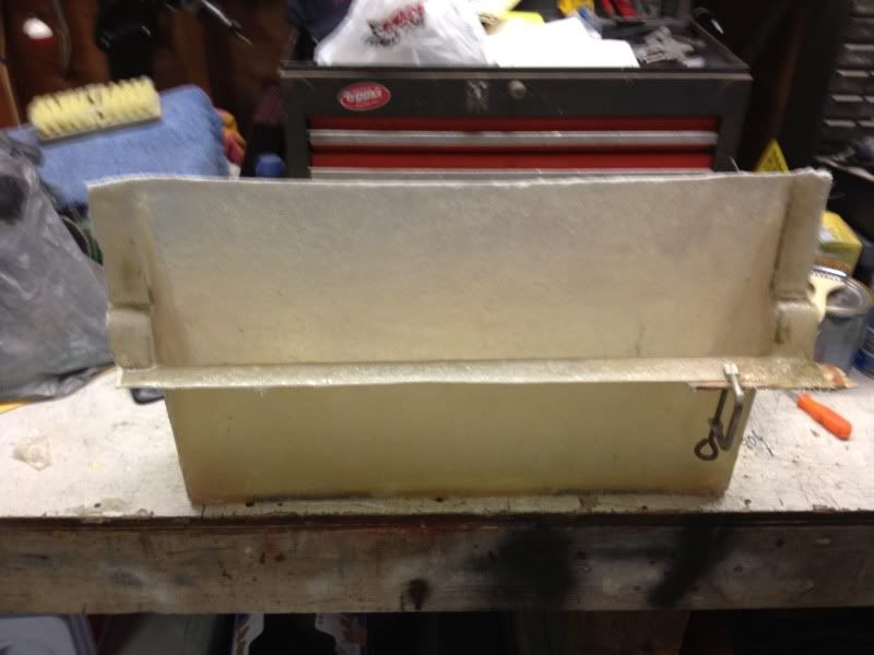

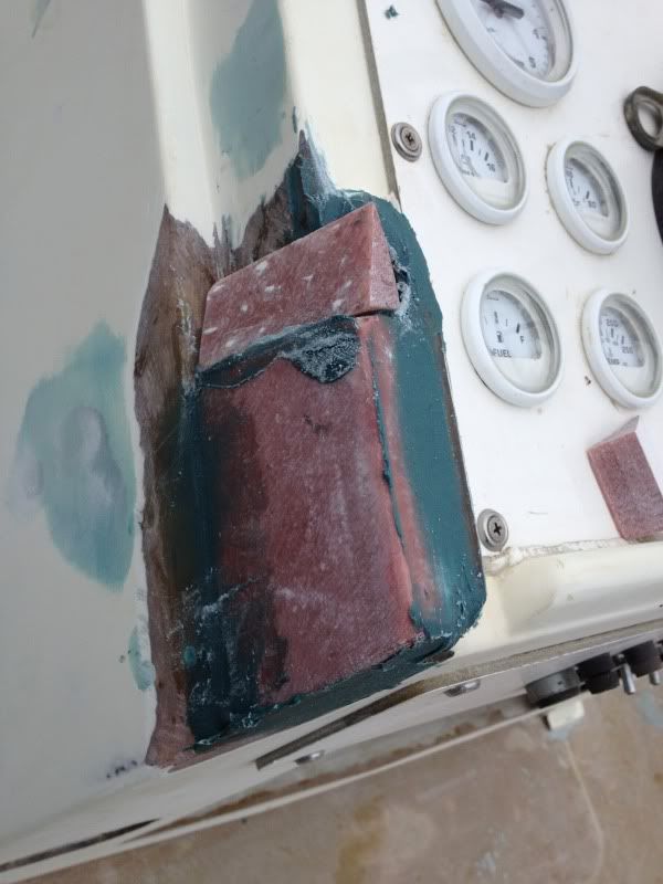

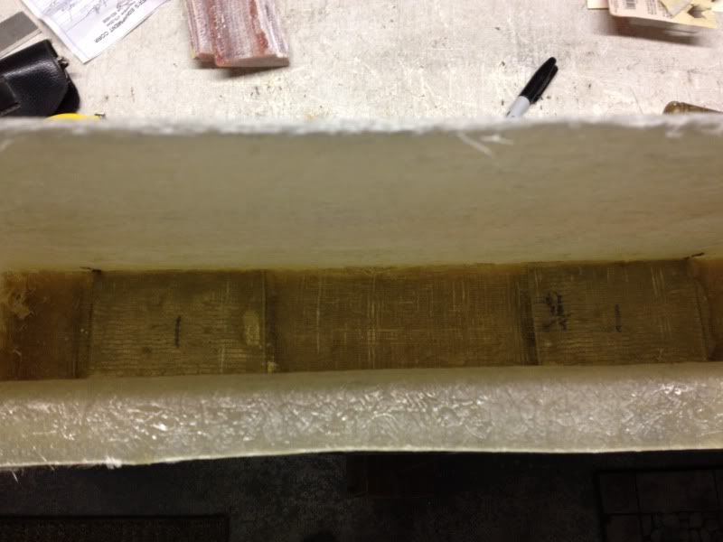

                        built out the console so the top can attach to the console. our fiberglass guy gave us a piece of a solid fiberglass stringer from the boats that he builds. we used this to make blocks to raise the height of the console.
                        BEFORE:
                        AFTER:
                        Laid some glass and resin to stick the blocks strong to the console, duraglas to fill.
                        SANDED DOWN SMOOTH:
