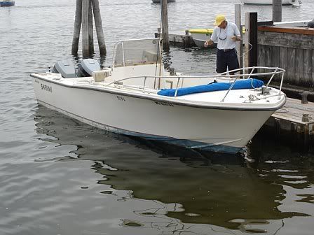

    Well, I finally sold my 22 and found a 25, which I have always wanted. Unfortunately it was all the way down in Miami, so I towed it up to the Boston area. Apparently she was bought new on the Cape by a wealthy family who rarely used it. They brought it down to Miami where it sat on a covered rack the rest of her life, up until a couple years ago. It was purchased as a second boat by a person who was more into go fast boats. He rarely used her and didn't enjoy putting in the work. So that's where I came in
    Here are a couple pics of the boat. Cosmetically, she is in rough shape. But the overall hull and floors are solid. The engines are from 1986 and look horrible, but all 12 cylinders were around 90 psi cold with no throttle. I don't know what my plans are for the engines yet, but i did get them going with a lot of work. All the wires were dry rotted and neglected. All the seals in the lower were also rotted and oil was full of water, so i had to go through both of those lowers.
    Oh yeah, the current name is 'shimubi' which is Japanese for 'everything beautiful'....yeah, that's getting sanded off....So far everyone likes to pronounce it with an L placed in the middle[(#)]

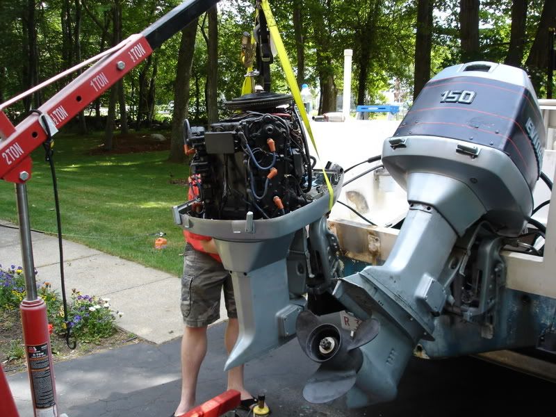

    The first order of business was to change out one of the trim pumps since it had a hole literally rusted through it. It was actually a pretty easy job. But why the motor mounting screws are only accessible from the back of the motor mount is beyond me. DT's engine hoist made easy work of it though. Once that pump was on and the system bleed, i was able to work on the engine with ease. When it comes to these 80's evinrudes, I think the engineering teams were on vacation during the time of discussion on ease of access to routine maintenance items. Disconnecting the shift shaft to drop the lower is a good time[!]

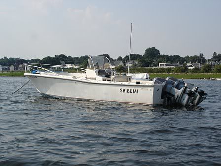

    I tell you, this was the first weekend I was able to enjoy the boat and had BOTH engines running. I was absolutely amazed at the quality of the ride. Compared to my 22, I think my knees will thank me. I still can't get over how you can blast through 5 footers with ease. And the sounds of twins is awesome! Even though they're 20 year old twins, they still sounds great. Needless to say, I can't wait to work on her and make her look as good as she rides[]
    Congrats on the new rig[8D]. I can't wait to watch progress of another great project. I bet those motors will run forever, that is if you can afford the fuel[:0][B)]. I love that hull and the way she sits in the water.
