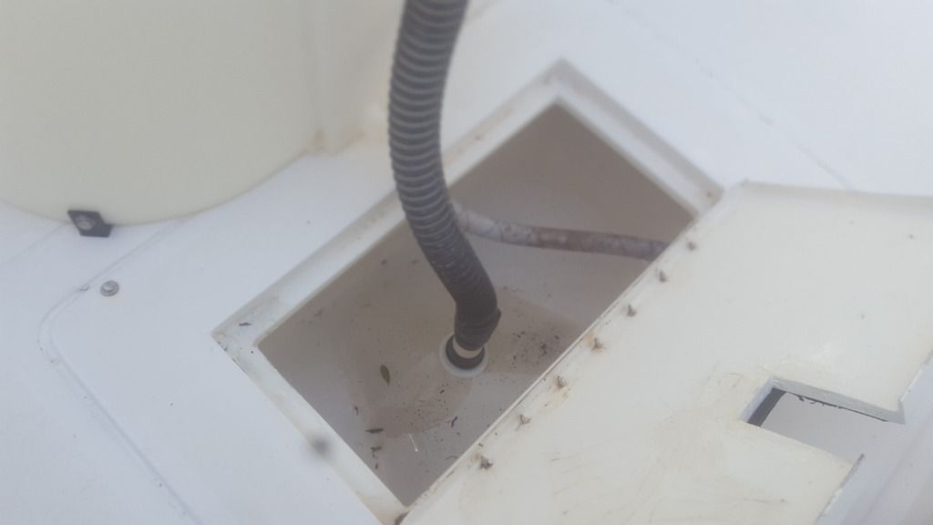

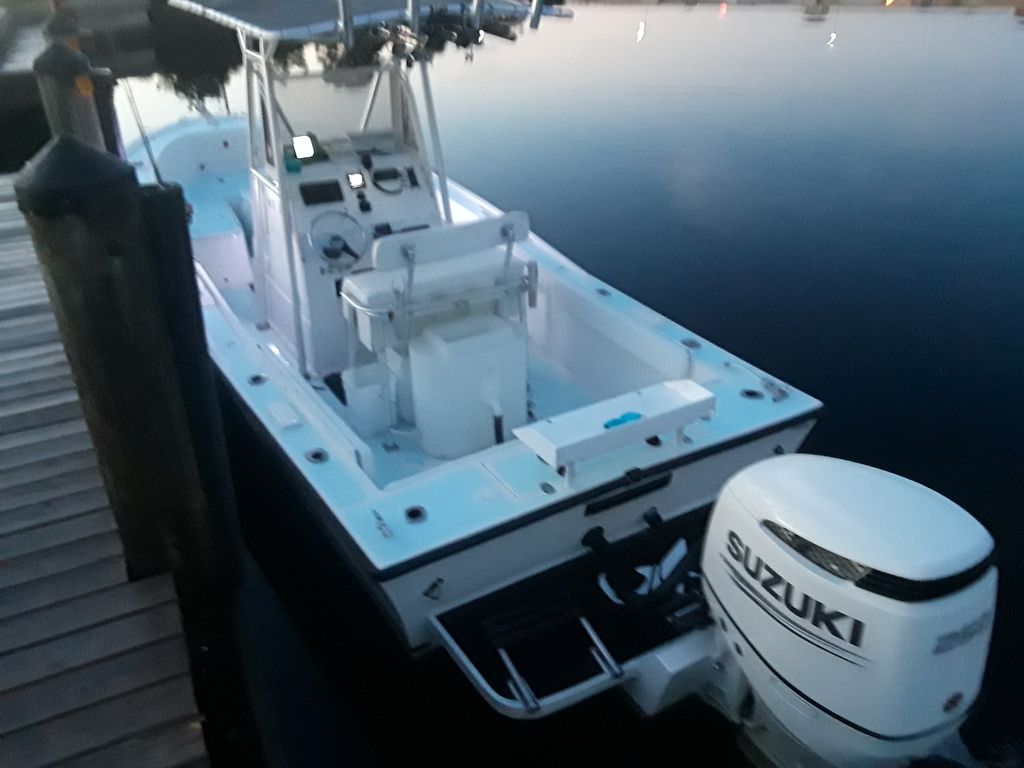

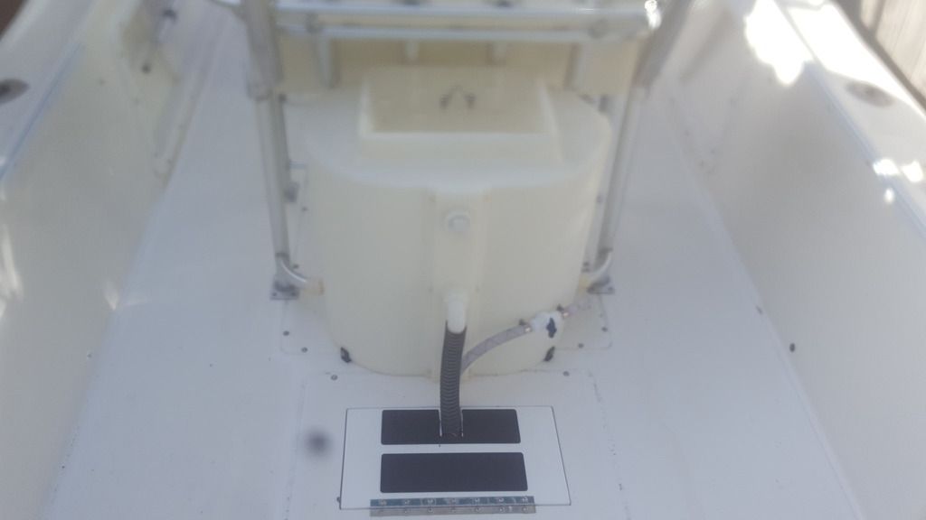

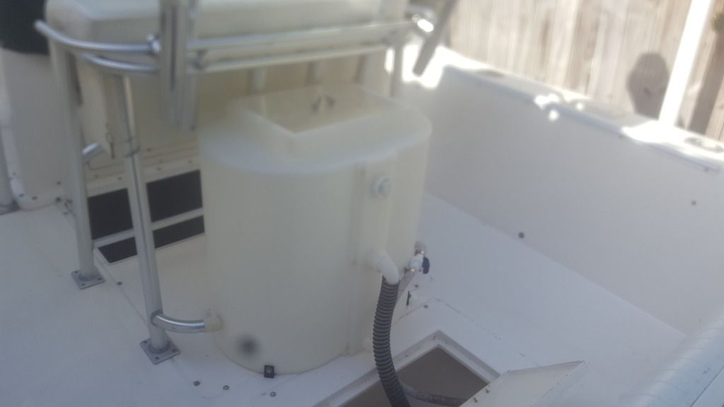

      This may be off topic but I completely get away with the baitwell on my 2:32 and did the same exact thing on my old 254 got tired of bending over and it just was never right.. I tied it into the existing Plumbing and it works great

                          Capt. Andy is right on, that's exactly where i'd put a livewell like I did on my 241, I cut the old in deck livewell out and made a nice hatch for even more bilge access and had a removable 30 gallon under the leaning post
