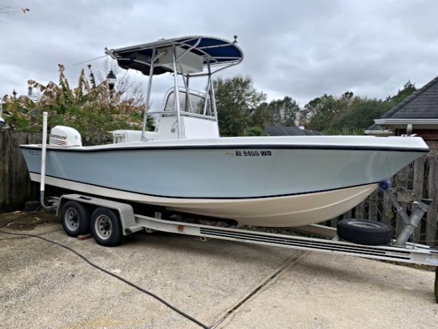

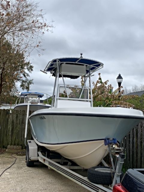

                          Update....I planned to get boat Saturday morning with head and midsection removed from the motor, and pay for 4 shop hours. There was a communication error at the shop, and the motor was put back together with upper motor mount repaired. I'm not confident with all I was told; never got written estimate (requested) and was told in conversation about the great deal they have on a mercury 4-stroke [}]. I have the boat; she looks great, motor fires off and runs great, and there is zero play in motor. Print out reads just as expected with 660 total hours. I have talked to another shop and will take and put inline tomorrow. I will pay for another inspection because I will sell in good faith.
                          Mako double stack. I can't wait until big boat photos as well as the 224...
                          Ran 3 200's on the muffs today, bet my neighbors love my 2-stroke collection [].
                            Glad it worked out a bit better than thought. Hopefully they did a quality repair and it was fair...
                              Looks like a Destin Mako convoy...but only in your driveway...where's the Sand Bar??? []
