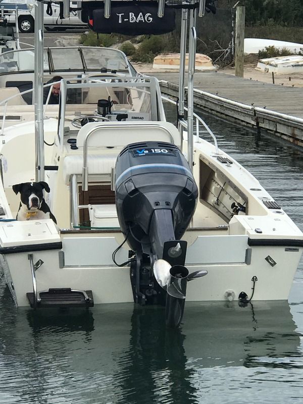

    I recently came across a pretty good deal on a counter rotating 03 OX66 150 to repower with. I know its not ideal with LH rotation but it was a deal I couldnt pass up. I replaced an old 85 140 Evinrude that had 1 bad cylinder. This motor is about 100lbs heavier than my old motor. Since Ive had this Yamaha I started taking waves over the transom when it gets sporty so I made the splash guards and they work well. I also changed to the ball scuppers (the clicking sound they make drives me nuts) cause my flapper type was letting lots of water in that would roll around the splashwell and slowly get through my pie plates and into the bilge. Pie plates are fairly new, I replaced them with new just over a year ago. I still have my 2 batteries in the starboard side stern and a 3 gallon oil tank on the port side. Ive been planning on moving them under the console for some time. I will definitely be doing it this winter. Would you all agree that my stern is to low? How much height will I gain by moving the batts forward? Also, in this photo I have a bout 45 or so gallons of fuel in the tank.

    Ive seen worse but you could argue that its a little low.
    Is that the ping pong I see on starboard. I dont think youll see much difference Moving batts. Maybe 1/2 .
    I think Ive seen pics of some guys seeing better gains than 1/2
      Maybe an inch low. I had my batteries under the console. And I assume the dog is at least 60 lbs.
            That is the ping pong ball and thats unfortunate news, was hoping Id see more than a 1/2 inch height gain
            I never had problems with water in the motor well.

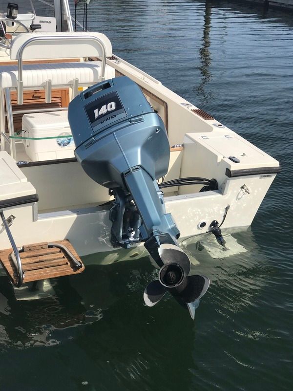

            I think an inch would make somewhat of a difference. And yes, Thor is a 90 pound American Bulldog. Ive attached a pic of my water line with my old 140.

            Waterline with my old 140

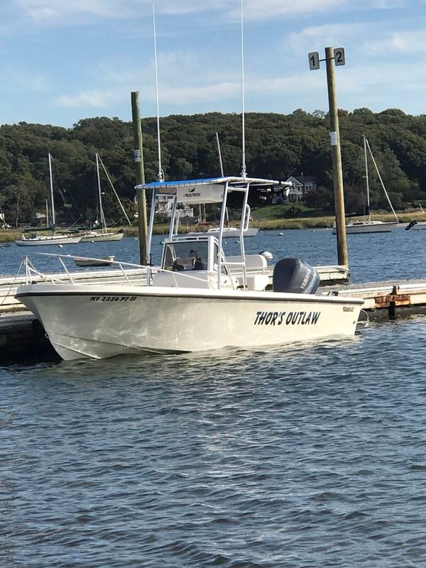

            Side shot with the Yamaha

              I think moving the batteries and oil would make a difference. In my 21 I had the batteries and the oil in the stern as well and I had similar issues. I moved the batteries to the console but left the oil tank, made a big difference in ride, and water splashing in while fishing. Let's just say the battier are 40 pounds each, the oil if the 3 gallon tank is full is roughly 20 pounds, plus removing the 90 pound dog you could have 190 less pounds in the stern that what is in your photo. Will it ride as high as with your 140, maybe not, but it will probably be close.

                If the Yamaha weighs 100lbs more then the evinrude, by moving the batteries and oil tank to the console will probably get you close to where you were, if we assume the console is the balancing point of the hull. Two batteries and 3 gal of oil will likely weigh 100+.
                If it doesn't change the waterline that much. It should still have some effect on how much the stern dips when the boat is rocking.
