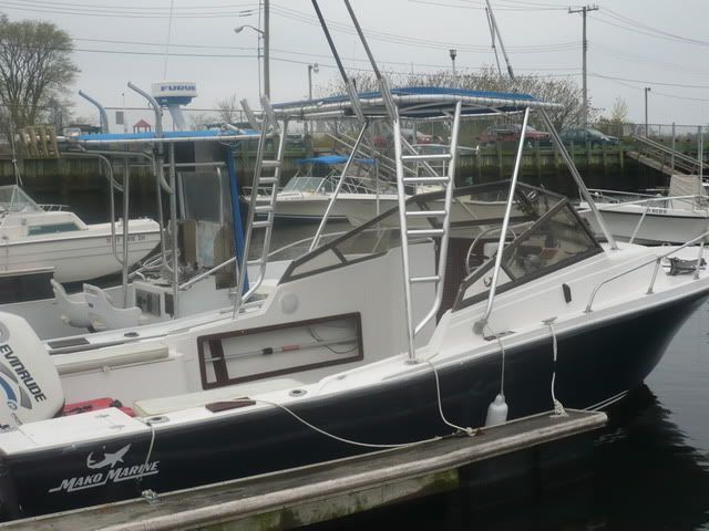

    Hey guys, hoping for some help. Im looking at buying a 1987 258. It is currently powered with a 250 hp Etec. I was wondering if anyone might have any idea if this is enough power for this model. Most of the research Ive done the 258 seems to be powered with twin 200s.
    I used to own a 228 with a 225 evenrude Fict... and the boat would get up to 42 mph.
    If anyone has any experience with the 258 model I would love to hear what you have to say in regards to how fast I can expect this boat to move? Will it struggle to get on plain? Will it burn fuel at a fast rate?
    Any info will be appreciated. Thank you
