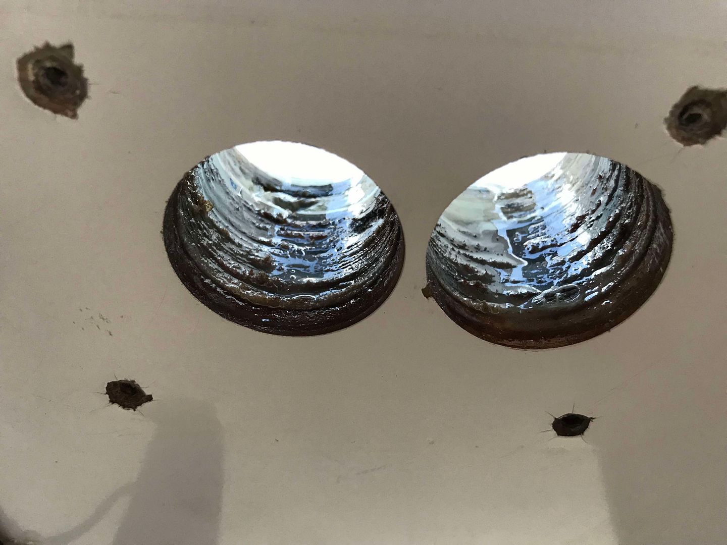

            Hi, not the bilge drain, but I just modified my deck drain scuppers.
            They were the copper 1.25" drain holes, two on each side, and two had cracked copper lips.
            I was afraid they could let water into the transom so I actually knocked them out this weekend, and found solid dry plywood in the transom.

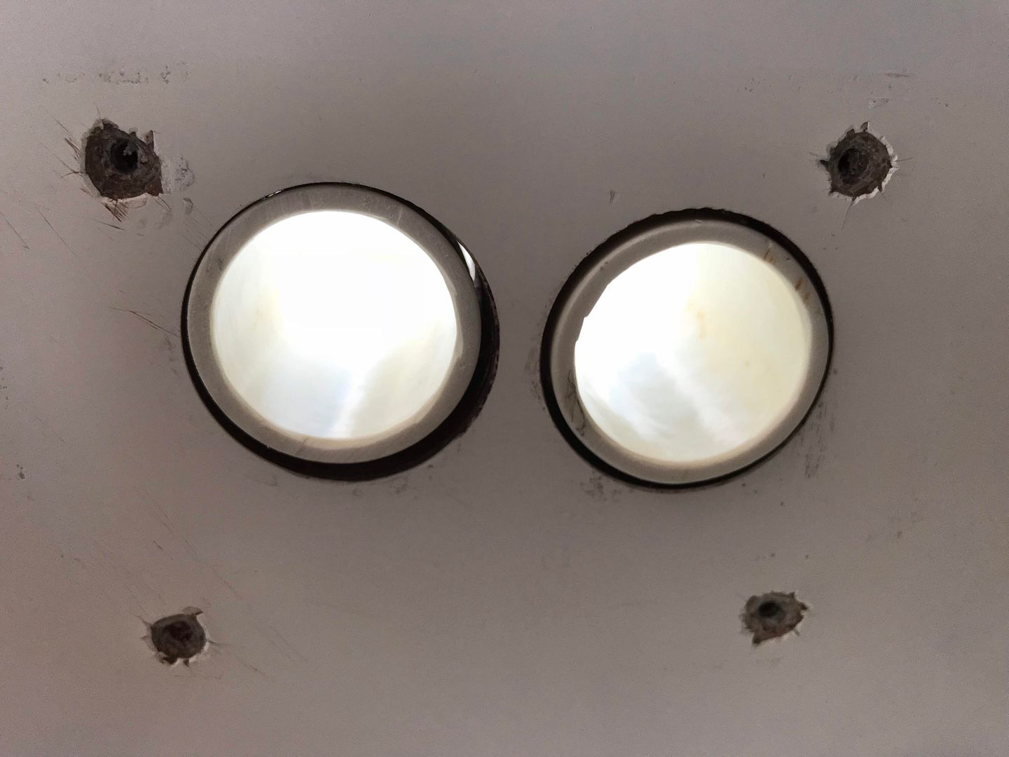

            I drilled the holes out, and glassed in pieces of PVC pipe, very happy with the results.
            And I did coat the would with epoxy resin and let that cure before glassing in the new PVC tubes. Here are a couple pictures of the process.

                    I did use West system epoxy resin. It is a little more expensive, but a quart kit with the pumps goes a long way and has a long shelf life.
                    I coated the wood first as shown, and after that dried I coated it again, and then wrapped the tubes in a piece of old school 4 oz woven cloth. I then taped up across the holes to keep the resin from flowing out.
                    After cleaning it up and sanding off the excess cured resin I filled a couple of voids with thickened epoxy.
