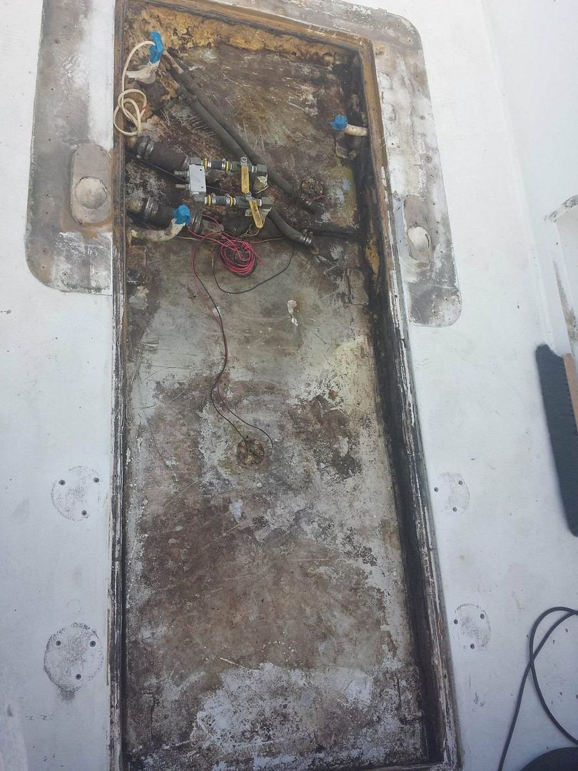

    I took the floor off the two tanks on my Mako. Looks like they have been replaced. One 100 gallon tank and a second 50 gallon tank. No smell of fuel and no pitting. The foam was not soaked, they were just dirty. Cant find the manufacture plate. Just curious what the opinions are for replacing or keeping. There are more pics on my project thread...

    If you think they have been replaced then I would just inspect all the lines and ground. While open, replace anything that is worn and give it a good cleaning. Your nose is usually the best indicator of a leak....usually. Have you noticed any fuel in the bilge ? Pressure tested?

      Definitely pressure test. Check the fill tube as well.
        Wife and I are making a decision to replace the tanks...better to be safe since we are this far into the project.

          Replace is best, especially since you don't know when these were put in, and since you've already got it all open. And while you're at it, definitely replace the entire fill line, vent line, and line to motor. You don't want to be opening it up later to do that--cost of hose is minimal; cost of labor and time huge.

                          Those are 100% original tanks, so good move to replace.
                          Although ugly, they do look to be in good shape. Mine were too, but once you've put the new one in, you're good "for life" so it's worth it.
